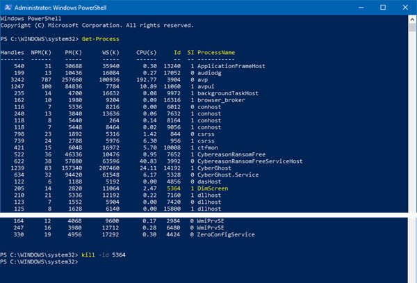

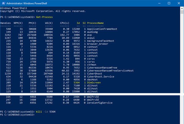

3] Using PowerShell
Open an elevated PowerShell prompt and execute the following command:
kill -id pid
Here pid is the Process ID number of the process to be terminated.
To get this number, you can open the Details tab of the Task Manager and see the number against the process you want to kill.
You can also run the following command in the PowerShell prompt that you have opened to get the process ID number.
Get-Process
For instance, 5364 is the PID for DimScreen.exe which is the process that I have chosen to terminate.
So, to kill this process, I use:
kill -id 5364
