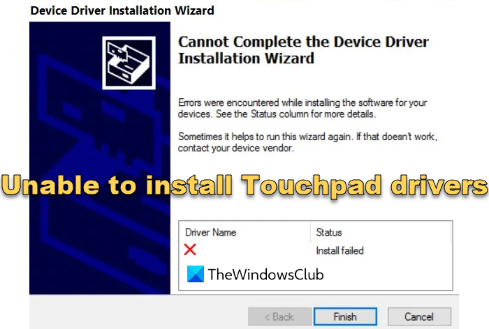

If you cannot install Synaptics, ASUS, etc, Touchpad drivers, and you see Cannot complete the device driver installation wizard error message, then this post shows how to resolve the issue.
Without the driver installed, you’ll be missing out on advanced gestures. For example, when you try to install the Synaptics Pointing Device driver, you may get the following error message.
Cannot complete the device driver installation wizard.
This happens with many laptop models, particularly the Asus Zenbook. The Asus Smart Gesture driver is prone to this issue. Users have noticed that the installation of this touchpad driver fails.
Unable to install Touchpad drivers on Windows PC
