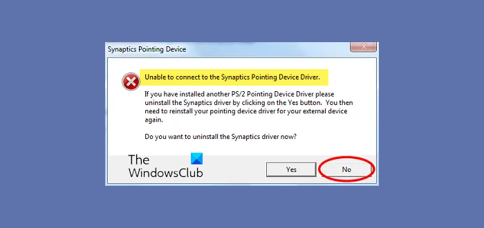

If you encounter the error – Unable to connect to Synaptics Pointing Device Driver while trying to access the system’s touchpad settings, this post could be helpful for you. Users dealing with this error might be unable to use the touchpad properly.
Unable to connect to Synaptics Pointing Device Driver in Windows 11
The primary cause of this issue is bad drivers. It could also occur due to problems with the Synaptics software package. You need to connect an external USB mouse before proceeding with the solutions.
- Uninstall the Synaptics Pointing Device driver and reinstall it from the manufacturer’s website
- Grant administrator permissions to the Synaptics utility

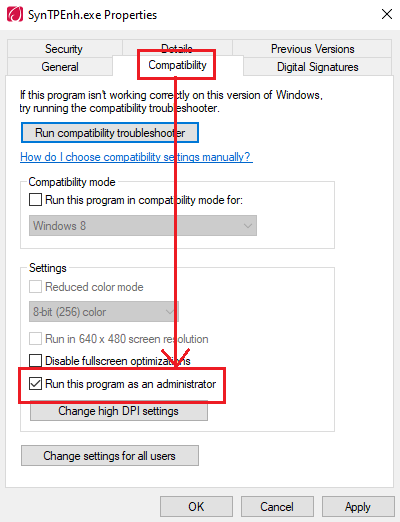

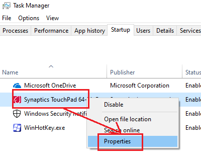

2] Grant administrator permissions to the Synaptics utility
The Synaptics utility has administrator permissions by default; however, Windows sometimes modifies them. This is necessary, or else the associated pointed device might not function properly. The procedure to grant administrator permissions to the Synaptics utility is as follows:
Right-click on the Taskbar and click on Task Manager to open the Task Manager window.
In the Startup tab, right-click on the Synaptics utility and select Properties.
Now in the Compatibility tab, check the box corresponding to Run this program as an administrator.
Click on Apply and then on OK.
Restart the system once done.
