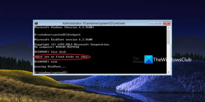

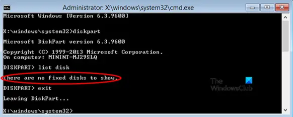

If you see the There are no fixed disks to show error when using the diskpart command in Windows 11/10, this post will help you resolve the problem. This usually happens when the computer can’t detect the connected hard drive. If it happens to the primary drive, then the computer might not boot at all. The same can happen with a USB drive or an external storage device. Let’s see how to fix it.
Fix There are no fixed disks to show Diskpart error
The error could be caused by a faulty cable or damage to the storage device. In either case, you can fix it. Depending on what caused the problem, one of these solutions should be able to fix the problem.
