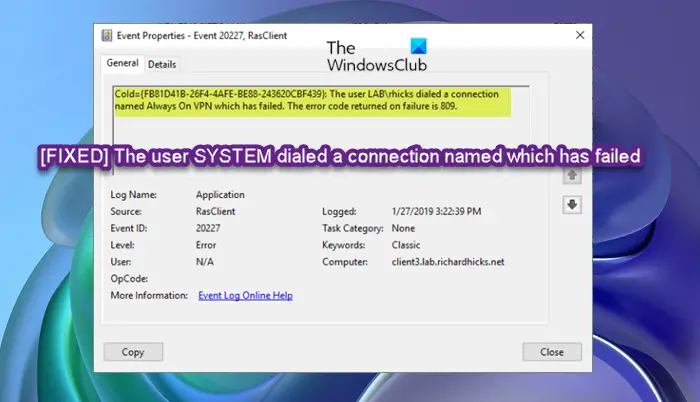

In addition, the Application Event Log as shown in the lead-in image above, records the error message below with Event ID 20227 from the RasClient source (that mentions error 720 or error 809):
The User [username] dialed a connection named [connection name] which has failed

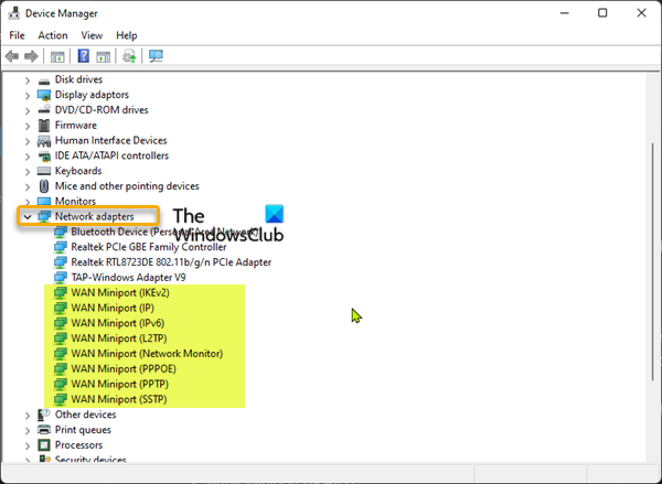

4] Reinstall WAN Miniport (IP) interface drivers
To reinstall the WAN Miniport (IP) interface driver on your Windows 11/10 device, do the following:
- In the Run dialog box, type devmgmt.msc and hit Enter to open Device Manager.
- Now, scroll down through the list of installed devices and expand the Network adapters section.
- Right-click one after the other all the network adapters whose name starts as “WAN Miniport” and then select Uninstall device. Here are some adapters that you may observe:
- WAN Miniport (IP)
- WAN Miniport (IKEv2)
- WAN Miniport (IPv6)
- WAN Miniport (GRE)
- WAN Miniport (L2TP)
- WAN Miniport (Network Monitor)
- WAN Miniport (PPPOE)
- WAN Miniport (PPTP)
- WAN Miniport (SSTP)
- Once you have uninstalled the devices, on the Device Manager menu bar, select Action > Scan for hardware changes to automatically reinstall your WAN Miniport devices.
- Exit Device Manager when done.
