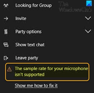

If you’re encountering the error message The sample rate for your microphone isn’t supported whenever you open the Xbox App and try to create a party, then you can try the solutions we will present in this post to resolve this issue successfully.
There are several different scenarios that could potentially trigger this issue. Here’s a shortlist with the most common culprits:

The sample rate for your microphone isn’t supported Xbox error
If you’re faced with this issue, you can try our recommended solutions below in no particular order and see if that helps to resolve the issue.

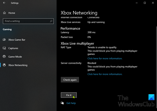

4] Change the NAT type
The inability to create parties can also be related to the fact that your NAT type is Closed which can cause this error. This can produce errors with various multiplayer games and can also interfere with the Xbox App ability to create and maintain parties.
You can resolve this issue by opening NAT. Here’s how:
- Press Windows key + I to open Settings app.
- Once you’re inside the Settings app, scroll down to the bottom o list and click on Gaming.
- From the Gaming section, select the Xbox Networking from the left pane.
- Wait until the NAT analysis is complete. If it reveals that the NAT type is closed, scroll down below and click on Fix it button to start the troubleshooter capable of opening it.
- Once the process is complete, restart your computer and see if the issue is resolved at the next startup sequence.
