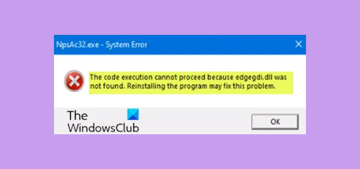

In what seems to be unusual behavior, some PC users might encounter the error message The code execution cannot proceed because edgegdi.dll was not found when they try to open some installed programs or apps on their Windows 10 device. In some cases, you might also get an error message when you try to open system programs like Task Manager. In this post, we will provide the most suitable solutions to resolve the issue.
Depending on the app or program you’re trying to launch, when you encounter this issue, you’ll receive the following full error message;
NpsAc32.exe – System Error, The code execution cannot proceed because edgegdi.dll was not found. Reinstalling the program may fix this problem.
- NpsAc32.exe is an executable file that is part of the Sage Fund Accounting Workstation program developed by Sage Software. However, this error can occur for other programs like AMFW.exe, Final Draft.exe, etc, too.
- Edgegdi.dll file is from Pathtrace Engineering Systems and is part of Pathtrace EdgeCAM.
This error prompt is most likely triggered by system conflict.
It should be noted that affected users reported that, the error prompt does not have any effect on the app or program, as when they click the OK button, the apps still launch and work normally. However, if you find the prompt irksome or it bothers you, you can continue below with the rest of the post and try the suggestions outlined.
Fix NpsAc32.exe System Error, edgegdi.dll was not found
