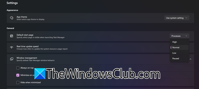

1] Check if the real-time update is paused
First of all, we need to check and ensure that the real-time update speed is set to Paused. It just determines how often the system updates its resource usage report. To get the real-time data quickly, you can set it to High. Once done, check if the issue is resolved.

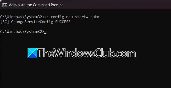

4] Check if Windows Network Data Usage (NDU) is enabled
One reason the Task Manager may not display Network or Disk usage is the absence of NDU, or Network Data Usage. If the NDU service is disabled, Task Manager won’t be able to display network activity. Usually, it gets disabled if a third-party network tool (e.g., Killer Networking Suite) or antivirus software is disabled.
To do so, open the Command Prompt as an administrator and then run the following command.
sc config ndu start-auto
Finally, reboot your computer.

How to fix Task Manager 0% network?
To resolve the issue where Task Manager displays 0% network usage, first ensure that the real-time update speed is set to High to receive immediate data. Next, run the Network Troubleshooter using the Get Help app to identify and resolve any connection issues. Then, update your network drivers to ensure proper communication with your system. Since these steps address the most common causes, they often restore normal network activity in Task Manager.
