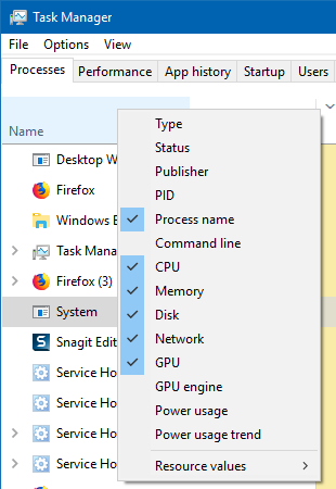

2] Ensure that display columns are selected
Make sure you have selected the columns you want to display. If none are selected, you may see no details. You have to right-click on the space near Name and select the columns.
