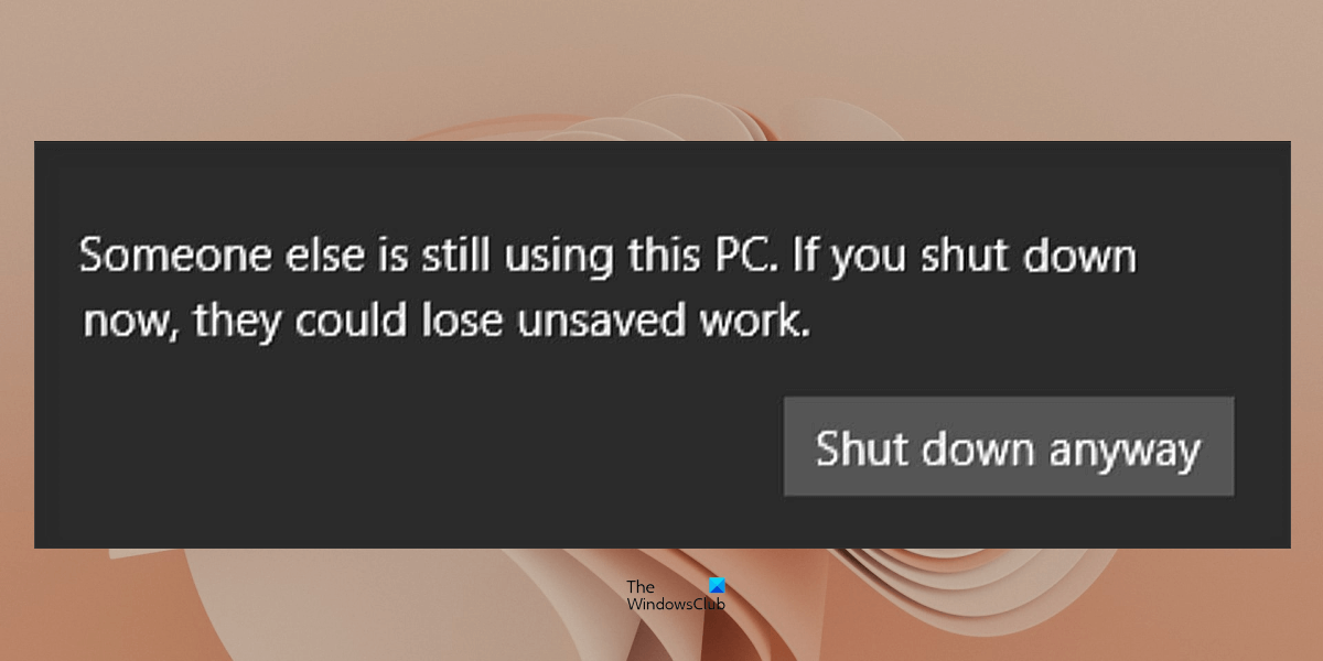

While shutting down or restarting your PC, you may see a warning message Someone else is still using this PC. Usually, this message appears when there is more than one user account created on a Windows computer and another user has switched his account instead of signing out. However, some users have reported that they received this message even when there is only one user account on their computer. In this case, this message seems suspicious as no other user is using the computer. In this article, we will discuss what the message Someone else is still using this PC means and how to fix this issue.
The complete error message is as follows:
Someone else is still using this PC. If you shut down now, they could lose unsaved work.
The purpose of displaying this message is to alert the user about unsaved work. If the user has unsaved work, he/she can log into his/her account to save the unsaved work before shutting down the system. This will protect users’ data from being lost.
You may wonder, “Windows tells me Someone else is still using this PC, but no one is; So what does this mean & what should I do?” Below, we have explained some suggestions to fix this issue on Windows PC. But before we proceed, let’s see some possible causes of this error message.

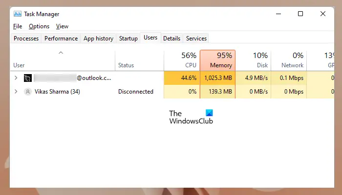

1] Check if another user is active or not
When more than one user is active on the same computer, you can view all of them in the Task Manager. The following steps will help you with that:
- Open the Task Manager.
- Go to the Users tab.
There, you will see all active users. Now, you can contact another user to confirm whether he/she has unsaved work or not. If not, you can sign out of his account from the Task Manager (if you are logged in to your system with an administrative account). If you are signed in to a Local account, you will not be able to sign out other users from the Task Manager. In this case, you have to tell that user to log in to his/her account and then sign out after saving the pending work to prevent data loss.
You may see the Disconnected in the Status of the other user account in the Task Manager. But still, Windows will show you the “Someone else is still using this PC” so that the other user can save the unsaved work by signing in to his account.

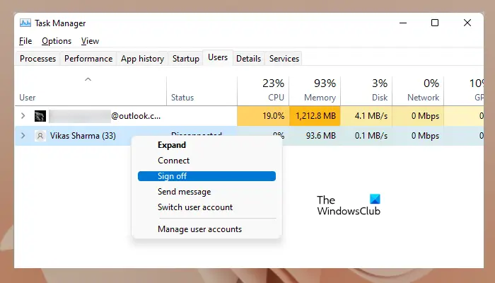

To sign out of other user accounts via the Task Manager, right-click on that user account and select Sign off. You may also see the Sign out option in place of Sign off.

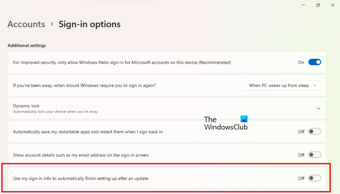

2] Change sign-in options
Another common cause of this issue is the sign-in options setting in Windows 11/10. Some affected users were able to resolve the issue by changing the sign-in options in Windows 11/10 Accounts setting. This may also work for you. Follow the steps listed below:
- Open Windows 11/10 Settings.
- Go to “Accounts > Sign-in Options.”
- Under the Additional settings section, turn off the “Use my sign-in info to automatically finish setting up after update” option.

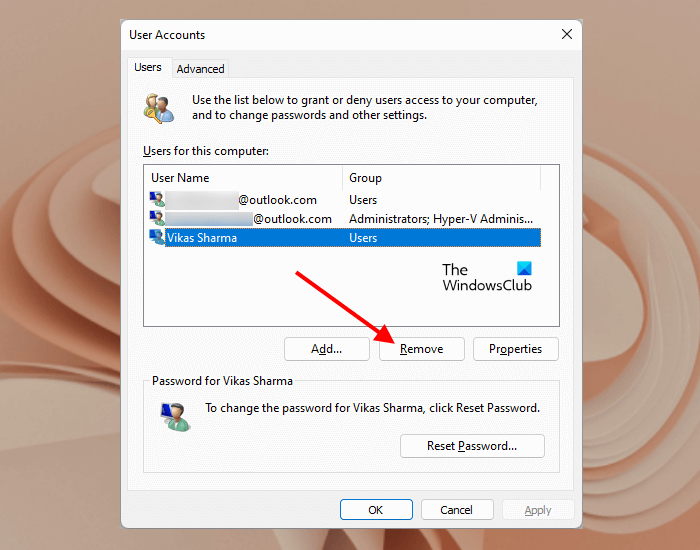

6] Remove the user account
If you have created multiple user accounts but you are the only user, you can remove the user accounts that you do not use. This will fix the problem. The steps to remove a user account on Windows 11/10 are written below:
- Open the Run command box (Win + R).
- Type netplwiz and click OK.
- The User Accounts window will open.
- Select the user account that you want to remove and click Remove.
Hopefully, the above fixes will resolve your issue. However, if you are sure that you do not have unsaved work on your system and no other user is signed in on your system, you can ignore this warning message and shut down your computer. This will cause no data loss.

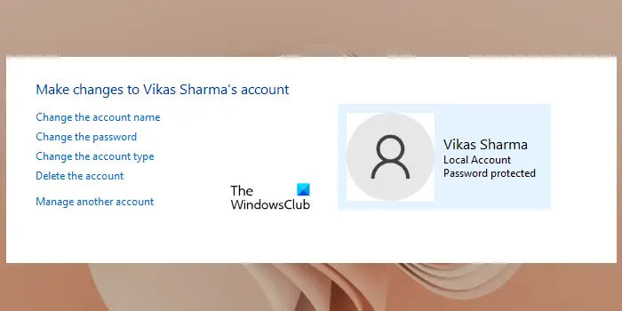

How do I get rid of a user on my PC?
You can get rid of a user on your PC by removing his/her user account. To do so, open the Control Panel and then go to “User Accounts > Remove Accounts.” Now, select the account that you want to remove from your system and then click Delete the account.

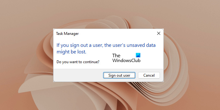

You can view all the active users in the Task Manager under the Users tab. To log off other users, go to the Users tab in the Task Manager, then right-click on the other user’s account, and select Sign off. You will receive the following confirmation message:
If you sign out a user, the user’s unsaved data might be lost.
Do you want to continue?
Click Sign out user. Do note that this action will delete the unsaved data of that user.
