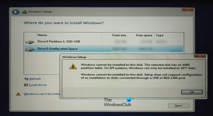

This article lists some solutions that will help you fix Windows cannot be installed to this disk. Setup does not support USB or IEEE 1394 port error while installing Windows 11/10. This error usually occurs while installing Windows OS on an external hard drive. However, some users also encountered this error while installing Windows 11/10 on an internal hard drive.
Windows cannot be installed to this disk. Setup does not support configuration of or installation to disks connected through a USB or IEEE 1394 port.
While performing Windows 11/10 installation, you must select the disk on which you want to install Windows 11/10. According to the users, a warning message appears on the bottom left side of the installation wizard screen. The complete error message is displayed after clicking on this warning message.
Below, we have mentioned some solutions to fix the Setup does not support configuration of or installation to disks connected through a USB or IEEE 1394 port error while installing Windows 11/10.

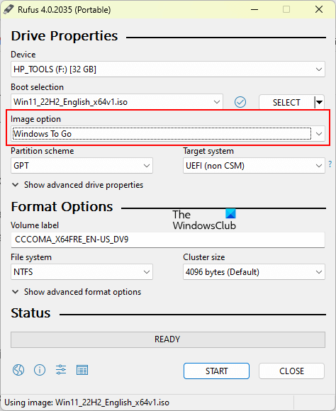

4] Use Rufus or another third-party software
You can also use third-party software to install Windows on an external hard drive. Rufus is one of the great tools available to install Windows OS. You can download Rufus from its official website. If you do not want to install it, you can download its portable version.
Open Rufus and select your hard drive from the Device drop-down. Now, click on SELECT and select the Windows ISO file. After that select Windows To Go in the Image option drop-down. Select GPT in the Partition scheme. When you are done, click START to begin Windows OS installation on the external hard drive.
If you do not see the targeted hard drive in the Device drop-down, click on the Show advanced drive properties option and select the List USB Hard Drives checkbox.
