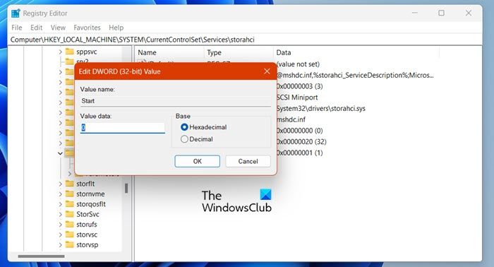

1] When installing Windows on top of an existing copy
If you already have an existing copy of Windows installed, there are some registry changes that should be made before enabling the option from BIOS. To do the same, boot normally to your OS, and launch Registry Editor. In Registry Editor, reach the following location.
Computer\HKEY_LOCAL_MACHINE\SYSTEM\CurrentControlSet\Services\iaStorV
Look for Start from the left section, double-click on it, and set it to 0. Now, go to the following location.
Computer\HKEY_LOCAL_MACHINE\SYSTEM\CurrentControlSet\Services\iaStorAV\StartOverride
Set the value of O to 0.
Now, navigate to the following address in Registry Editor.
Computer\HKEY_LOCAL_MACHINE\SYSTEM\CurrentControlSet\Services\storahci
Set the value of Start to 0
Finally, change the value of 0 to 0 at the following location.
HKEY_LOCAL_MACHINE\SYSTEM\CurrentControlSet\Services\storahci\StartOverride
You can now reboot the computer and check if the issue is resolved. Hopefully, this will do the trick for you. In case, you still get the same error message while making a partition, move to the next solution.

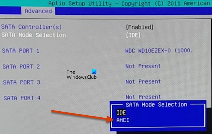

2] When doing a fresh installation
If you are installing a fresh copy of Windows, make use of this guide. It is worth noting this solution works for both scenarios, so, if for some reason, the above method fails, go for this. Here, we will enable AHCI mode from the BIOS of your computer. So, follow the steps given below to do the same.
- Turn on your computer and boot into BIOS.
- Go to Advanced.
- Look for SATA Mode Selection and change its value from IDE to AHCI.
- Save the settings and exit the BIOS.
Note: Options in BIOS depend on the OEM, so, if you are confused check your OEM’s website.
You can now install the Operating System without any error message. Do keep in mind that on some systems, changes made to the BIOS take a little longer than usual to save. So, if you are one such user, after making the changes, wait for a few minutes (5 to 10) and then check if the changes made are saved or not. Hopefully, this will do the trick for you.
