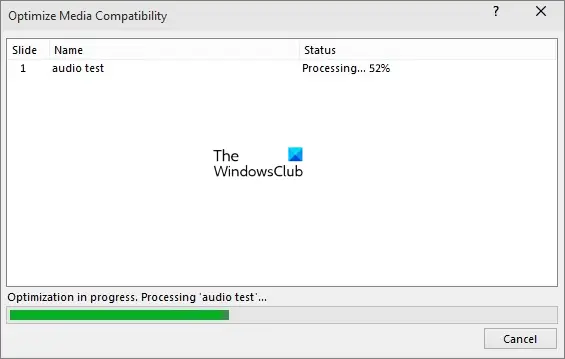

3] Optimize Media Compatibility
The Optimize Media Compatibility option appears in PowerPoint if the format of the media inserted in your presentation might have compatibility issues with other devices. If you do not see this option in PowerPoint, it means that the media format you have inserted in the PowerPoint presentation does not have any compatibility issues.
To optimize media in your presentation for compatibility, follow the instructions below:
- Launch Microsoft PowerPoint and go to “File > Info.”
- Check if the Optimize Media Compatibility option is there. If yes, click on the Optimize Compatibility button to begin the test.
Wait till the process gets completed. After the completion of the optimization process, check if the issue persists.

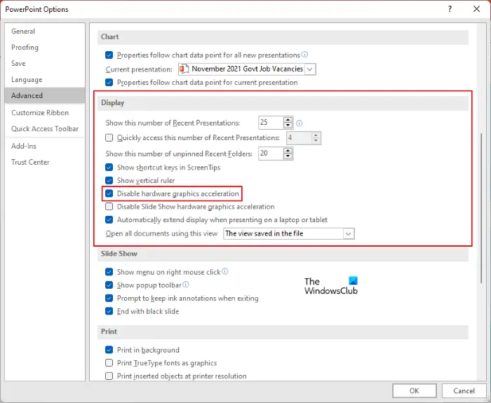

2] Disable Hardware Acceleration
Disable the Hardware Acceleration and see if it brings any changes. We have written the instructions below:
- In Microsoft PowerPoint, go to “File > Options.”
- Click Advanced on the left side.
- Now, scroll down the right side and enable the Disable hardware graphics acceleration checkbox. This option is available under the Display section.
- Click OK to save the changes.
