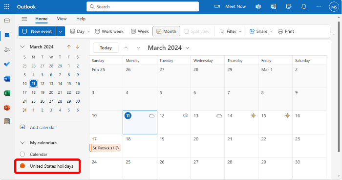

How to fix the Outlook Calendar web app not syncing?
It is possible that the Outlook app is syncing properly but the Calendar is not visible, causing the issue. In this case, you should check if the Calendar is selected. If not, then select the account.
For this, open the Outlook Calendar > expand My calendars on the left sidebar > locate the calendar that’s not syncing > select it if not selected already.
Alternatively, you can remove the calendar that’s not syncing and reconnect it with the Outlook Calendar as shown in Method 5.
