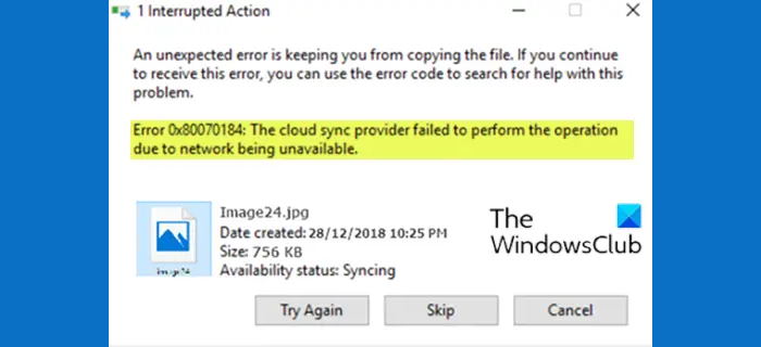

You may encounter the OneDrive Error 0x80070184, The cloud sync provider failed to perform the operation due to network being unavailable when you try to sync your files with OneDrive on your Windows 11/10 device. In this post, we will provide the most suitable solutions you can try to successfully resolve this OneDrive sync error.
OneDrive Error 0x80070184: The cloud sync provider failed to perform the operation due to network being unavailable
If you’re faced with this OneDrive error, you can try either of the recommended solutions below to resolve the issue.
