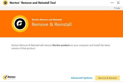

7] Uninstall/Reinstall Norton Secure VPN
You can uninstall Norton Secure VPN from your device, then follow the steps below to reinstall the app.
- Sign into your account at my.norton.com/.
- In the My Norton portal, under Secure VPN, click Download.
- Click Agree & Download, and then save the installer.
- Next, double-click the installer file that you downloaded and follow the on-screen instructions to complete the installation.
Alternatively, you can use the Norton Remove and Reinstall Tool.
Hopefully, any of these solutions should work for you! Else, you can contact Norton Support or use an alternative VPN solution for Windows PC.
