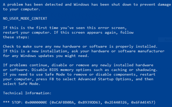

The NO USER MODE CONTEXT, 0x0000000E stop error can occur when a program is trying to leverage the use of a system driver but fails to do so. Some of the causes of NO USER MODE CONTEXT bluescreen of death error are corrupted or incompatible drivers, incorrectly configured Windows Registry entries, Malware infection, damaged memory locations, etc. This Stop Error occurs infrequently and indicates that an attempt to enter user mode with no context was made.
Fix NO_USER_MODE_CONTEXT Blue Screen
If this is the first time you have restarted after installing additional hardware, remove the hardware and restart again. Check the Microsoft Hardware Compatibility List to verify that the hardware and its drivers are compatible with your OS. If that does not help, then the following potential fixes will be carried out to fix NO_USER_CONTEXT stop error on Windows 10-
