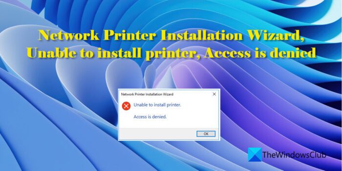

If you get Unable to install printer, Access is denied error while trying to install a new printer through the Network Printer Installation Wizard, then this post may help resolve the issue. A few Windows users have reported this issue while adding a Network Printer through an existing port and driver in Print Management. A few others have experienced the error while installing the printer without administrator rights.
Network Printer Installation Wizard – Unable to install printer. Access is denied
Network Printer Installation Wizard, Unable to install printer, Access is denied
If you see Unable to install printer, Access is denied error on your Windows computer, then the following suggestions may help resolve the issue:
