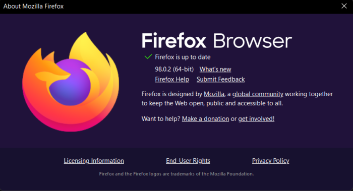

1] Check for Firefox updates
It is always recommended to keep your software up to date. Though Firefox automatically installs the updates whenever they are available, we suggest you check for Firefox updates manually. To do so, follow the steps written below:
- Open Firefox.
- Click on the three horizontal lines on the top right side.
- Go to “Help > About Firefox.”
After that, Firefox will check for updates. If you are using the latest version, you will see the following message:
Firefox is up to date

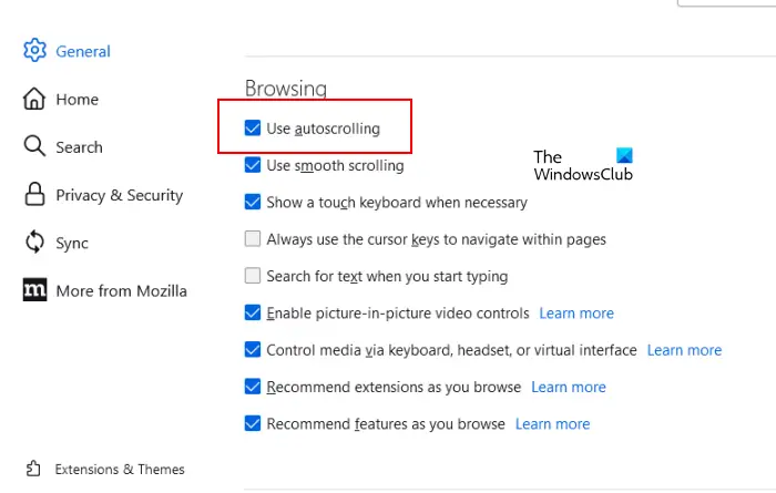

2] Check Firefox settings
When you click the middle mouse button on a web page in Firefox, your mouse cursor turns into an arrow icon. If both vertical and horizontal scrolling is available on the web page, you will see four arrow icons pointing towards the left, right, top, and bottom. If horizontal scrolling is not available on the web page, you will see only two arrow icons pointing toward the top and bottom. Now, you can move your mouse cursor in any of these four directions to scroll the page without using the scroll wheel.
This feature does not work if the Use autoscrolling option is disabled in Firefox. Check if this is the case with you or not. The following steps will help you:
- Click on the three horizontal lines on the top right side in Firefox and select Settings. Alternatively, you can type about:preferences in a new tab and hit Enter.
- Select the General tab on the left side.
- Scroll down and locate the Browsing section.
- Make sure that the Auto scrolling checkbox is selected. If not, select it.

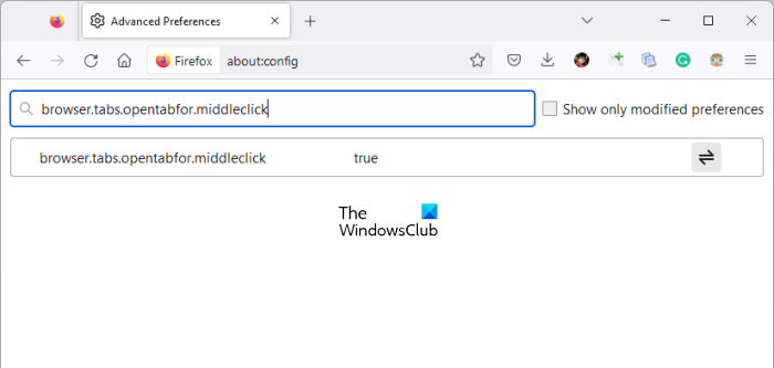

3] Modify Firefox configuration settings
If the middle click is not opening links, modifying the configuration settings will fix the problem. The following steps will guide you on this:
- Open a new tab in Firefox.
- Type about:config and press Enter.
- Click Accept the Risk and Continue.
- Type browser.tabs.opentabfor.middleclick in the search bar. It should show the value as True.
If the value of browser.tabs.opentabfor.middleclick is set to false, double-click on it to change it to true. After that, Firefox will start opening links in new tabs when you use your mouse middle click.

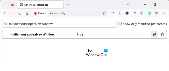

Tip: You can also make the middle click of your mouse open the links in a new window instead of new tabs in Firefox. To do so, you have to create a new value in Firefox by using the Configuration Editor.
Open a new tab and type about:config, and hit Enter. Click on the Accept the Risk and Continue button. Now, type middlemouse.openNewWindow in the search bar. Select Boolean and click on the Plus icon next to it. Now, double-click on it to change its value to true. After setting its value to true, change the value of browser.tabs.opentabfor.middleclick to false.
