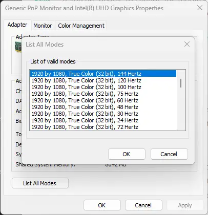

3] Increase Refresh Rate via Advanced Display Settings
Another thing you can try is increasing the refresh rate via the advanced display settings. Here’s how:
- Navigate to System > Display > Advanced Display.
- Click on the clickable link – Display adapter properties for Display 1.
- The properties dialog will now open here; click on List all modes and select your desired mode.
- Click on OK to save the changes.
