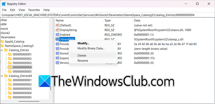

3] Remove Problematic Registry Entry
When software can’t be uninstalled, orphaned registry entries force Windows to load the blocked DLL at startup. Therefore, deleting these entries sever the link between the OS and the insecure DLL, preventing the LSA conflict without removing the software itself. However, before we go ahead and make any changes to the registry, create a backup of the registry.
Once done, follow the steps mentioned below.
- Open the Registry Editor.
- Then, go to the following location.
HKEY_LOCAL_MACHINE\SYSTEM\CurrentControlSet\Services\WinSock2\Parameters\NameSpace_Catalog5\Catalog_Entries
- Check every subfolder under Catalog_Entries and Catalog_Entries64.
- Look for keys where LibraryPath or ProviderPath values point to the blocked DLL (e.g., C:\Program Files\Bonjour\mdnsNSP.dll).
- Right-click on each problematic registry and then select Delete.
Once done, your issue should be resolved.

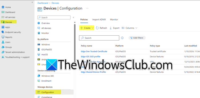

4] Add DLL Exclusions via Intune
This solution is only geared towards enterprise users. We are going to whitelist blocked DLLs in Microsoft Intune. It directs LSA protection to ignore specific unsigned/insecure modules, overriding default security enforcement for critical business software. Follow the steps mentioned below to create an exclusion policy.
- Open Microsoft Intune Admin Center.
- Go to Devices > Configuration profiles or Configure and then create a profile.
- Now, make sure to follow the details given below.
- Platform: Windows 10 and later.
- Profile type: Custom
- Name: LSA Exclusion for Bonjour or something else
- OMA-URI: Paste the exact path above.
- Value: Full path to the blocked DLL.
- Assign to device groups and deploy.

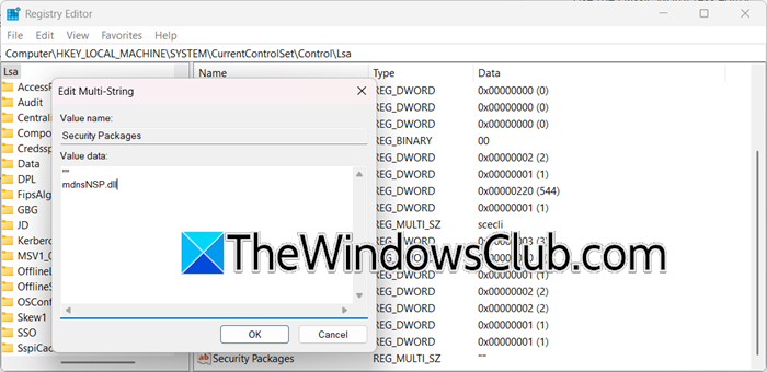

5] Add DLL to LSA Security Packages
We can grant the DLL full access to plaintext passwords in the LSA process, creating a credential-theft vulnerability; therefore, it should be a last resort. You can follow the steps mentioned below to add a DLL to LSA Security Packages, but make sure to create the registry backup (mentioned earlier) before that.
- Open Registry Editor.
- Go to the following location.
HKEY_LOCAL_MACHINE\SYSTEM\CurrentControlSet\Control\Lsa
- Look for Security Packages, double-click on it, and mdnsNSP.dll or your blocked DLL.
Finally, reboot your computer.
