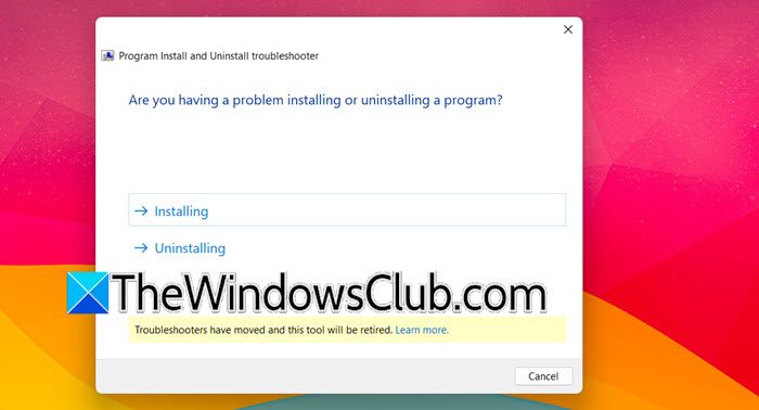

3] Clean Uninstall and Reinstall Using the Microsoft C++ Redistributable Cleanup Tool
When a Visual C++ redistributable becomes corrupted after a Windows Update rollback, the standard uninstall process may fail due to corrupted entries or missing cache files in the Windows Installer database. The Microsoft Program Install and Uninstall Troubleshooter is a tool that can scan for these issues, forcibly removing stubborn registry keys and installation records, allowing for a fresh installation to succeed.
Follow the steps below to do the same.
- First of all, download MicrosoftProgram_Install_Uninstall file from Microsoft.
- Right-click the downloaded file and select Run as Administrator.
- When the tool launches, choose Uninstalling from the first screen.
- Scroll through the list of programs and select the specific Microsoft Visual C++ Redistributable that is causing problems. If you do not see it in the list, select Not Listed and manually type the name of the redistributable (e.g., “Microsoft Visual C++ 2015-2022 Redistributable”).
- Click Next and allow the troubleshooter to scan and forcefully remove the program. It may take a few minutes to clean up all registry keys and installation fragments.
- Once the removal is complete, restart your computer. After reboot, download the latest supported Visual C++ Redistributable packages directly from Microsoft and install them with administrator privileges.
You can even use the Get Help troubleshooter to use the Uninstall troubleshooter. Just open the Get Help app (it is preinstalled), search for Microsoft Program Install and Uninstall Troubleshooter, and then go through the results.

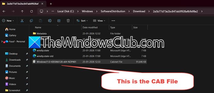

4] Manually Install the Specific Version from the Update Cache
Sometimes, Windows Update downloads the correct version but fails to apply it. Go to C:\Windows\SoftwareDistribution\Download folder. Sort by date to find folders modified on the day of the problematic update. Look inside these folders for .cab files containing VCRuntime or VCRedist. You can right-click these .cab files and select Extract. Inside the extracted folder, you will often find the actual .exe installer for the VC++ Redist. Running this installer manually forces the installation that Windows Update attempted and failed to complete properly.
