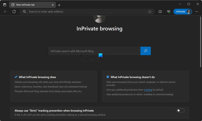

2] Check if you are able to download files in InPrivate mode
You might be facing this issue due to some problematic extensions installed in your Edge browser. To check if there is some interference by a third-party extension, you can open an InPrivate tab and try downloading files.
For entering InPrivate mode, press the Settings and more button and choose the New InPrivate window option. Or, you can quickly press the Ctlr+Shift+N hotkey to open the InPrivate window. Now, you can download the previous files that were giving you the problem at hand and see if the issue is fixed.
If the problem is fixed in the InPrivate window, you can disable your extensions to permanently resolve the issue. Here’s how:

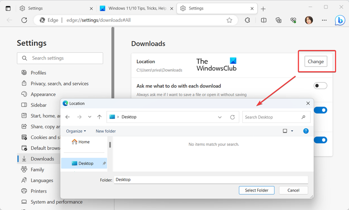

3] Change your Download location
It might be your download location for Edge causing the issue. The downloads won’t complete if your download folder is running out of free space to accommodate more files. Or, if there is some other issue with the current download location. Hence, if the scenario applies, you can change your download location and check if the problem is fixed. Here’s how:

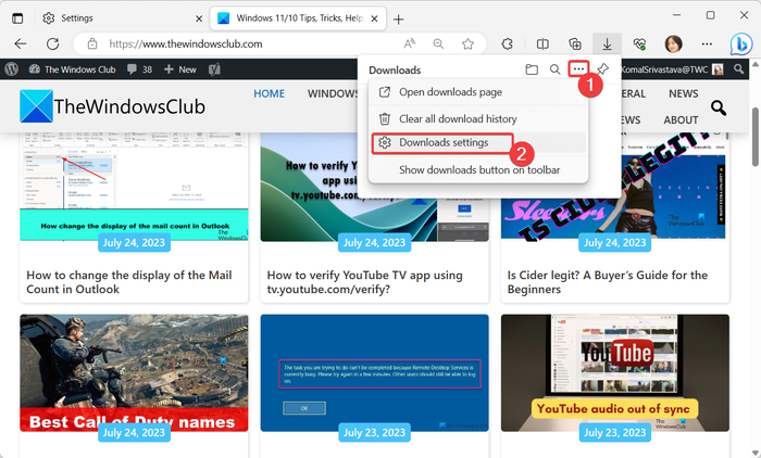

First, open Edge, click on the Settings and more button from the top-right corner and choose the Downloads option. Alternatively, you can press the CTRL+J hotkey to open the Downloads prompt.
Next, in the appeared Downloads panel, press the three-dot menu (More options) button and then click on the Downloads settings option.
Now, press the Change button present next to the Location option and select some other locations to save your downloads from Edge.
When done, you can retry downloading files and check if the problem is resolved.

- First, open, Edge, click on the Settings and more button, and select Downloads.
- Next, click on the three-dot menu button inside the Downloads panel and choose the Download settings option.

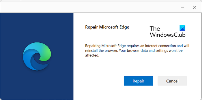

6] Repair Edge
Some corruption associated with the Edge browser can also prevent you from successfully downloading files from the internet. Hence, to fix the issue, you can repair the Edge browser. Here’s how:
- First, close your Edge browser using Task Manager.
- Now, open Settings by pressing Win+I and move to Apps > Installed apps.
- Next, select the three-dot menu button present next to Microsoft Edge and click on the Modify option.
- After that, you will be prompted with a Repair Microsoft Edge dialog window; simply choose the Repair button.
- Once the browser is repaired, it will restart.
You can now retry downloading files from the internet and see if they still get stuck at 100% or if the issue is resolved.
