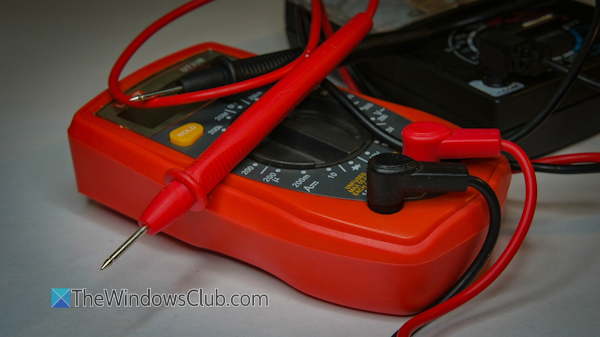

3] Check the laptop charger for output voltage
If there is an incorrect voltage supply, that can also be why your laptop touchpad is not working properly when you connect the charger. To confirm, first, flip the power adapter or charger brick and look for the output voltage mentioned there. Now use a voltmeter or multimeter, plug in the charger, and test it to get a voltage readout. Compare the output reading with the voltage mentioned on the laptop charger. If the output is similar, the adapter will work fine. If not, you may have to change the power adapter.
Also, make sure that you are using the original charger or adapter for your laptop and that it’s not damaged (wires are not exposed). We all know the danger of using cheap cables and chargers, yet sometimes, we fall for them. A cheap charger can start creating issues from starting or over some time. Therefore, we should always use the original product for our electric equipment, not just the laptop.

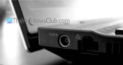

6] Check the laptop charging port
The problem may reside in the laptop charging port as it happened with one of the users with the same problem. For example, if the input jack or charging pin (round pin found in some laptop models) is bent or pushed back inside the laptop or the charging port is loose or damaged, that can cause such an issue. In this case, you need to replace the laptop charging port or let the professional do the task.
