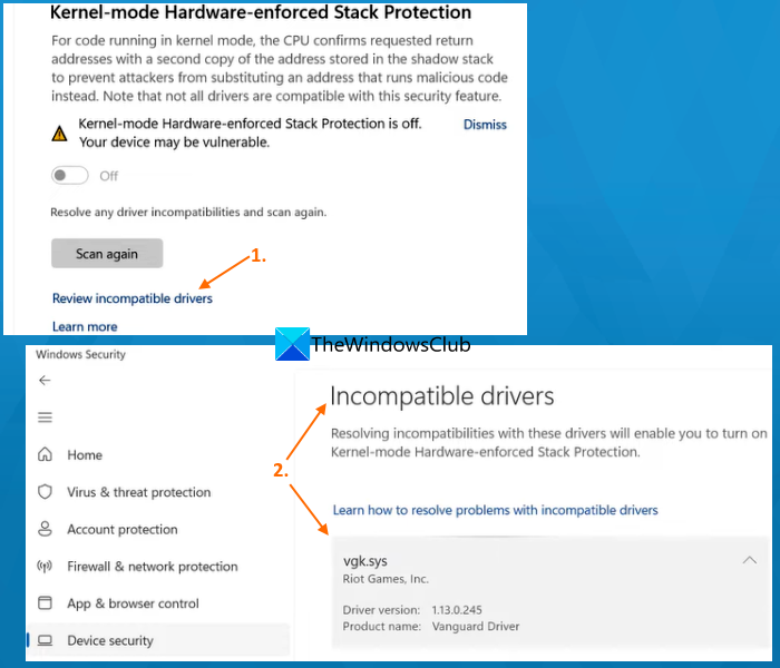

3] Review Incompatible Drivers and Update them
Some device drivers are not compatible with this security feature of Windows 11. So, unless there are incompatible drivers, the Kernel-mode Hardware-enforced Stack Protection option can’t be turned on. Thankfully, there is a way to fix this issue as the feature itself provides a list of incompatible drivers that you can review to update.
Do note that this solution can be used only if the Kernel-mode Hardware-enforced Stack Protection toggle can be used. If the option is greyed out, then you need to check other solutions.
First of all, open the Windows Security app, access this feature, and use the toggle available for this feature to turn it on. The toggle or button will automatically turn off immediately. After that, click on the Review incompatible drivers option (as visible in the image above). Now a list of Incompatible drivers like BEDaisy.sys, vgk.sys, etc., will be visible. Mainly, the list contains game-related drivers but you may find conflicting drivers for other apps also.
Note: For some users, the Incompatible drivers section was empty and didn’t show any drivers in the list. But, if you see a list of such drivers, it will be easier to fix the issue.
Select a driver from the list, and you can see the program or app associated with that driver, the product name, and the driver version. It doesn’t provide an option to update drivers that may fix incompatibility issues so you need to do it manually.
To update drivers on Windows PC, you can either download the latest version of required drivers from the official website or manufacturer’s website or use the Optional updates section of Windows Update in the Settings app to check if driver updates are available to download and install.
Restart your PC and see if you can turn on the Kernel-mode Hardware-enforced Stack Protection feature. This should work. If not, press the Scan again button available just below this feature to check other incompatible drivers and update them. You can also disable or uninstall the incompatible drivers, but then it will make the associated devices stop working.

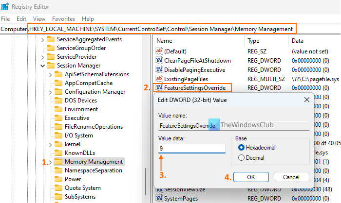

5] Enable Kernel-mode Hardware-enforced Stack Protection using Registry
You can also use Registry Editor to access or create a Registry entry that overrides the feature settings to enable kernel-related protection with a feature-specific value data number. In this case, we are going to access or create the same Registry entry and then enter the value data required for enabling the Kernel-mode Hardware-enforced Stack Protection feature. Before you use this option, we recommend you take a backup of your Windows Registry. After that, follow the steps added below:
- Type regedit in Windows 11 Search box and hit Enter to open the Registry Editor
- Access the Memory Management Registry key where multiple memory-related settings (such as enable/disable paging executive, paging files, paged pool size, etc., are present). The path to jump to this key is:
HKEY_LOCAL_MACHINE\SYSTEM\CurrentControlSet\Control\Session Manager\Memory Management
- On the right-hand section, look for the FeatureSettingsOverride DWORD value. If it is not present, then create it manually. Right-click on an empty area, New menu, and click on DWORD (32-bit) Value option. When this value is created, name it FeaureSettingsOverride
- To enable the Kernel-mode Hardware-enforced Stack Protection feature, you need to set the Value data of FeatureSettingsOverride value. To do this, double-click that value
- A small pop-up appears. Here, put 9 in the Value data
- Press the OK button
- Close the Registry Editor.
Restart your system if needed. Now the Kernel-mode Hardware-enforced Stack Protection feature shouldn’t be greyed out anymore and you will be able to turn it on.
