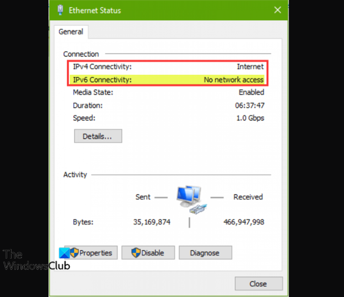

Some Windows users may encounter the IPv6 Connectivity, No network access error when attempting to connect to a network on Windows 11 or Windows 10 computer. In this post, we identify the potential triggers and provide the most effective solutions to remediate the issue.
Why does IPv6 say No network access?
If you have encountered the IPv6 No internet access problem on your Windows PC, it’s most likely due to you’re using the wrong ethernet driver or it’s out of date or corrupted or damaged. In any case, to resolve the issue, update your Ethernet network card drivers. The most likely culprits to this error include-

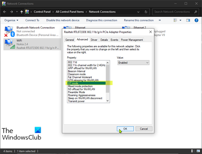

8] Set Network Adapter to HT mode
HT mode allows you to specify which modes to support High Throughput (802.11n) and/or Very High Throughput (802.11ac).
This solution requires you to set the network adapter to HT mode on your Windows PC. Here’s how:
- In the Run dialog box, type ncpa.cpl and hit Enter to open Network Connections control panel.
- Next, right-click your active network adapter and select Properties.
- In the properties window, click Configure button.
- In the network adapter properties window, click Advanced tab.
- Select HT mode under Property section.
- Click OK.
- Exit Network Connections control panel.
- Restart PC.
Check if you can now connect to the network; otherwise, try the next solution.
