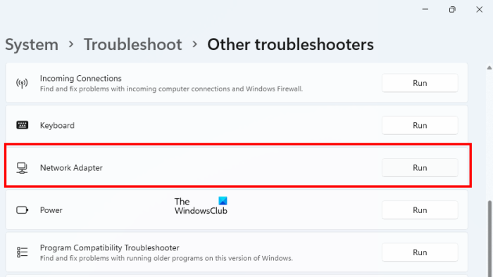

4] Run the Network Adapter troubleshooter
The Network Adapter troubleshooter is an excellent tool that checks for issues with network connections between your computer and connected network devices. Then it fixes those problems if possible. The procedure to run the Network Adapter troubleshooter is as follows.
- Right-click on the Start button and select Settings from the menu.
- In the Settings window, go to System > Troubleshoot > Other troubleshooter.
- Click on Run corresponding to the Network Adapter troubleshooter.
- Once the troubleshooter has completed its job, you can reboot the system.
