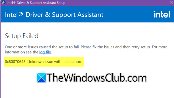

The Intel Driver & Support Assist tool allow you to download and install the latest version of the driver on your computer and assist you with some other useful software. However, when trying to install the Intel Drivet & Support Assist, we faced Installation error 0x80070643. This is mostly caused due to the absence of Microsoft Visual Studio C++ Redistributable and other related components. In this post, we will talk about this issue and see what you can do to resolve it.
Setup Failed
One or more issues caused the setup to fail. Please fix the issues and then retry setup. For more information see the log file.
0x80070643: Unknown issue with installation
Intel Driver & Support Assist Installation error 0x80070643

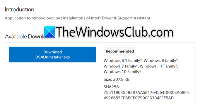

1] First run the Intel Driver & Support Assist uninstaller and then install the app
Intel Driver & Support Assist is a built-in tool that comes preinstalled on a lot of computers. We suspect that even in your case, the assistance was installed but was uninstalled for some unknown reason. Therefore, we recommend you install the uninstall first, run it, and then see if your issue is resolved. To download Intel Driver & Support Assist Uninstaller’s installation media, go to intel.com, then run the installer to install the application on your system. Once done, run the uninstaller, if it removes something, reboot your computer, and then install Intel Driver & Support Assist. Hopefully, this will do the job for you.

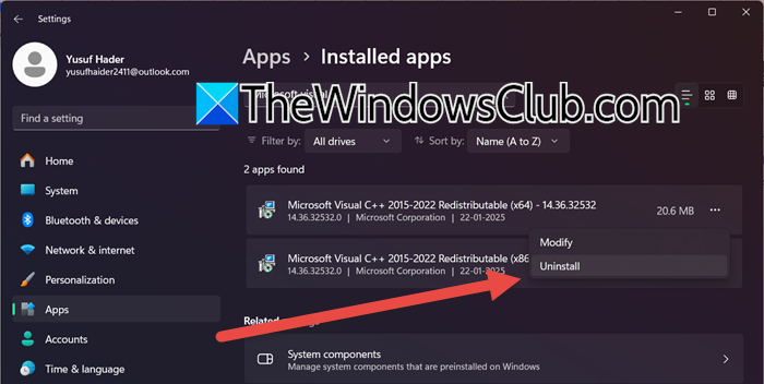

2] Repair Microsoft Visual C++ Redistributable
You might have a corrupted installation of Microsoft Visual C++ Redistributable, which is preventing you from installing the Intel Driver & Support Assist. To rectify this, we can repair the installation by following the steps mentioned below.
- Open Settings by Win + I.
- Then, go to Apps > Installed apps.
- Search for “Microsoft Visual Studio C++ Redistributable”, click on the three dots, and select Modify.
- Click on Repair.
Let the process complete, and once it is done, check if the issue is resolved.

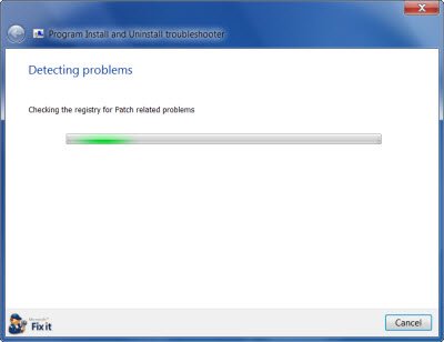

5] Run Program Install and Uninstall troubleshooter
The Program Install and Uninstall troubleshooter helps you fix problems that stop you from installing or removing programs, which in this case, is Intel Driver & Support Assist, not just that, also repairs damaged registry keys. In order to use it, first go to microsoft.com and download the troubleshooter from there. Once you have downloaded the troubleshooter, run it. So, if the issue is because of a corrupted registry or anything else that our troubleshooter can detect, it will do so, and resolve it.
6] Reinstall Microsoft C++ Redistributable
If all else fails, our last resort is to uninstall all the available versions of the Microsoft C++ Redistributable from your computer. You can go to Settings > Apps > Installed apps, search for “Microsoft C++ Redistributable”, click on the three dots, and select Uninstall. Once done, you can go ahead and install the latest version of Microsoft C++ Redistributable from the hyperlinked website. Hopefully, this will do the job for you.
