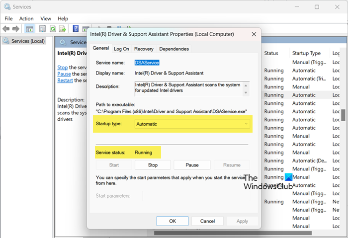

1] Check Intel DSA Service and Intel DSA Updater service
First, we need to check and ensure that the Intel Driver and Support Assistant and Intel Driver and Support Assistant Updater services are running. These services are responsible for running the Intel Driver and Support utility and scanning for updates. To do so, follow the steps mentioned below.
- Open Services by searching it out of the Start Menu.
- Look for Intel Driver and Support Assistant, right-click, and click on Properties.
- Make sure that the Startup type is set to Automatic and it is running; if the service is stopped, click on the Start button.
Do the same with Intel Driver and Support Assistant Updater service and check if the issue is resolved. If the services are already running, try restarting them to negate the possibility of a glitch.

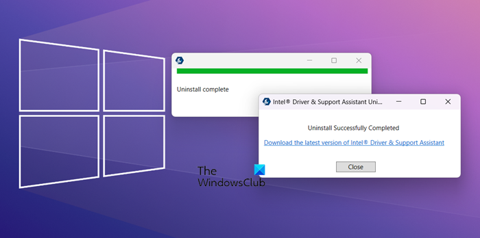

3] Reinstall Intel DSA
If all else fails, our last resort is to completely uninstall Intel Driver Support and Assistant and install a fresh copy. To do so, go to intel.com and download the Intel Driver and Support Assistant Uninstaller. After uninstalling the utility, download and install a fresh copy of Intel DSA.
