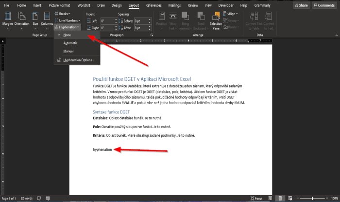

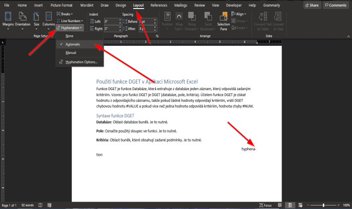

Turn on Automatic Hyphenation to break lines and hyphenate words in Word
Open Microsoft Word.
On the Layout tab in the Page Setup group, click the Hyphenation button.
In the drop-down list, click Automatic.
Read: How to Change Background Color and Add Drop Caps in Word.
Turn off the Automatic Hyphenation in Word
In the drop-down list, click None.
Read: How to configure Grammar and Style Settings in Word.
