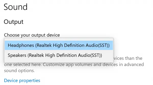

1] Manually Set Headphones as the Default Device
Sometimes, when a headphone is plugged in, it does not toggle the default audio device or default playback device. In this case, you can just set the default audio device to the headphones.
Right-click on the volume control icon on the system tray and select Open sound settings. It will open the Sound section in the Windows Settings app.
Under the section of Output, select Headphones for Choose your default output device.
This should enable the headphones to work on your Windows 10 device.
