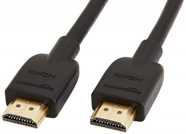

HDMI or High Definition Multimedia Interface is an audio/video interface that can be used to interconnected multiple multimedia devices. However, if the HDMI port is not working properly on a Windows laptop, here are some solutions you should take a look at.
The most common use for this is when a CPU is connected to a monitor and a projector. It can also be used to connect Bluray players and laptops to televisions or monitors. The main advantage that it offers is the fact that it has a single connection to transmit both audio and video at high quality like 4K. But if you find that after connecting devices using this port, the screen appears to be black, and there is no audio output then here are a few things you need to take a look at.
