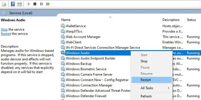

5] Restart Windows Audio service
Like all other components, Audio is also available as an audio service. If the service keeps stopping or has stopped, you will not listen to the audio.
Type Services.msc in the Run prompt (Win +R), and press the Enter key. In the services list, locate Windows Audio service. Right-click on it, and choose to restart. If the service is stopped, you can choose to start.
Also, make sure to do the same for Windows Audio Endpoint Builder as the Windows Audio service depends on it.

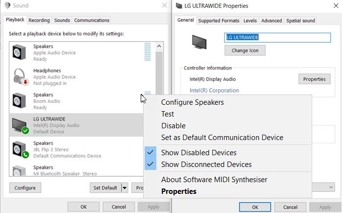

8] Check HDMI Playback settings in Sound Panel
Open the Sound control panel, and locate the speaker in the Playback list of devices. If you cannot figure it out, right-click on it and select properties. If you see HDMI Digital or anything similar, then that’s your speaker.
You can then right-click on it to test the speaker, disable and enable it, and set it as the default communication device.
Follow these steps to set the device as Default Device
- Open Control Panel> Click on Hardware and Sound
- Click open Sound applet
- Under the Playback tab, right-click in the blank space
- Select both ‘Show Disabled devices’ and “Show Disconnected Devices”.
- Now right-click on HDMI Output.
- Click on Properties
- Under the General tab click on Device Usage and select Use this Device:(Enable).
- Click Apply. Click OK.
After doing this, under the Playback tab, click on HDMI Output and select Set as Default.
Click Apply > OK and exit.
