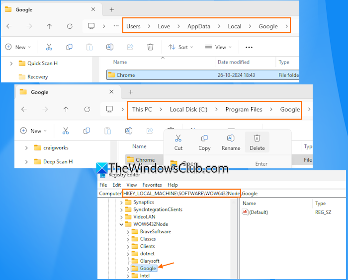

3] Completely remove Chrome browser and reinstall it
After uninstalling a program or app, its residual files (say Registry entries, empty folders, etc.) may remain on the PC. Because of this, you can face trouble while installing the program again. So, if this is the reason you see a no update available error when installing Chrome on your Windows PC, then completely remove the Chrome browser and reinstall it. Once you have uninstalled Google Chrome using the Control Panel or Settings app, follow these steps:
- Open File Explorer, type
C:\Users\%username%\AppData\Local\Googlein the address bar, and press Enter. Delete the Chrome folder - Access C:\Program Files\Google and delete Chrome folder from this location
- Go to C:\Program Files (x86)\Google and remove Chrome folder
- Navigate to the following path in the Registry Editor window and delete the Google key:
HKEY_LOCAL_MACHINE\SOFTWARE\WOW6432Node
Restart your PC and run the Google Chrome installer. Now, you will be able to complete the installation process.
