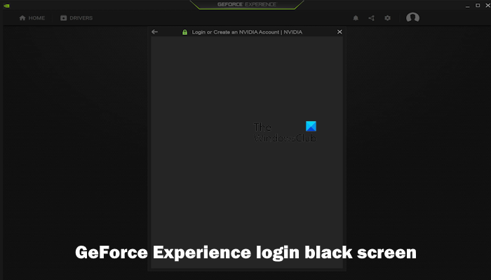

In this article, we will show you how to fix the GeForce Experience login black screen issue on Windows 11/10. It usually occurs due to an unstable internet connection, corrupted DNS cache, outdated or corrupted Graphics Card driver, etc.
Fix GeForce Experience login black screen
Before you begin, restart your internet connection and your PC. Sometimes, this issue can occur due to a temporary glitch. If the NVIDIA GeForce Experience login black screen still troubles you, follow these suggestions:

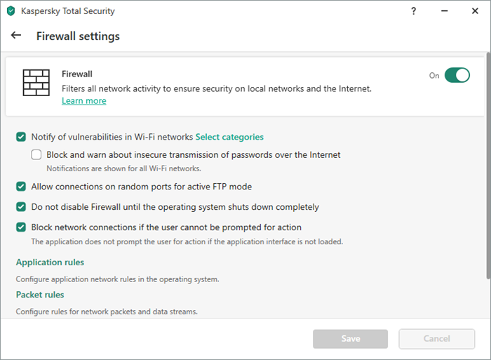

3] Temporarily disable your firewall and see
Sometimes, internet connectivity issues occur due to the firewall, creating login problems. To check this, turn off your firewall and see if it works. If this works, your firewall is causing the problem. In such a case, you can allow the GeForce Experience app through the Windows Firewall.
If you use a third-party firewall, contact their support team to learn how to allow an app.
