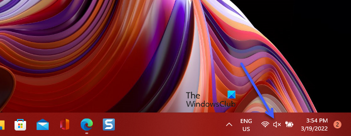

First of all, we need to make sure that your audio is not muted. To do that, look at your taskbar and see if you see the Speaker and Cross icon, similar to the one in the screenshot. Also, open your game’s settings and make sure that you have not disabled the audio. If you see no such issue, move to the next solution.
