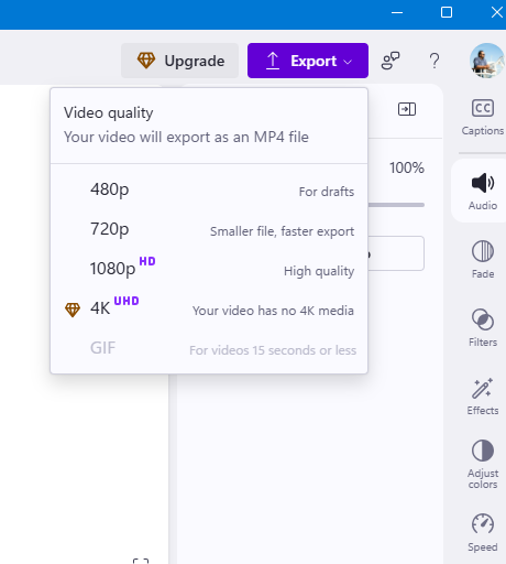

2] Change Export Settings
You should try changing export settings and see if that works. For some users, disabling Hardware Acceleration worked, whereas for others, changing the resolutions did the job. So, try turning off hardware acceleration encoding, and if that doesn’t work, then, unfortunately, you need to lower the resolution.

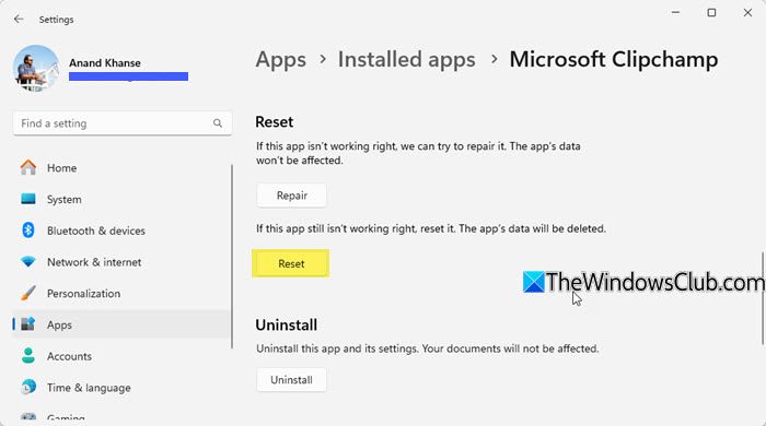

4] Reset or Repair Clipchamp Video Editor
If the app is misconfigured or corrupted, you should reset or repair it. Follow the prescribed steps to do so.
- Open Settings.
- Go to Apps > Apps & Features.
- Look for Microsoft Clipchamp.
- For Windows 11: Click on the three vertical dots and select Advanced Options.
- For Windows 10: Click on the app and select Advanced Options.
- Click on the Repair button.
If that doesn’t work, try clicking the Reset button. Hopefully, this will do the job.

How do I export a video from Clipchamp Video Editor?
To export a video in Clip Video Editor, follow these steps:
- After editing it, click on Finish video.
- Press the Export drop-down
- Then, select the Video quality and click Export.
- Now, you will be asked to select a location where you want to store the file and name it. Do that and click Export.
Your file will be exported.
