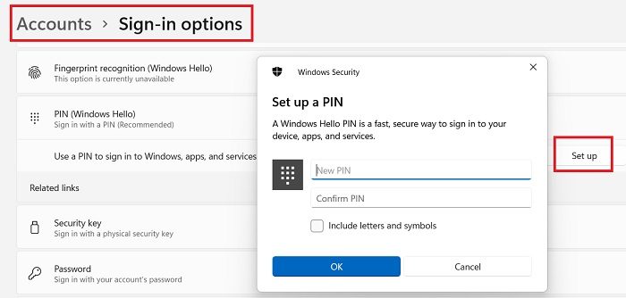

2] Login using your password and Reset your PIN
Obviously, you first need to log in to reset your PIN, so you can use your password to log in here and then reset or remove the PIN to avoid this error.
- Press Win+I to open Settings.
- Go to Accounts > Sign-in options.
- Go to Use a PIN to sign in to Windows, apps, and services.
- A new pop-up will open where you can reset your PIN
- This normally works, but if it doesn’t work for you, move on to the next fix.

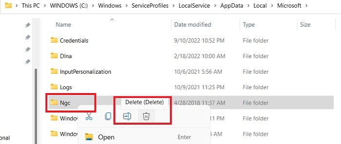

3] Boot in the Safe Mode and delete NGC Folder
If you cannot log in for any reason or error, you can boot your PC into Safe Mode and make the required changes. Here we need to delete the NGC folder in your PC to avoid this PIN error. For those who don’t know, the NGC folder on our PC holds your PIN-related data and if any of the data in this folder gets corrupted, you will not be able to log in using your PIN.
When we delete this folder, the system automatically creates a new one and this may help you get rid of the Error 0x80280013.
To enter into Safe Mode- Power off your computer and turn it on again. Before the Windows load, press the power button and hold it for at least 5 seconds.
Repeat it and your PC will boot into the recovery mode
Go to Troubleshoot > Startup Settings > Enable Safe Mode.
Once you have entered the Safe Mode, navigate to
C:\Windows\ServiceProfiles\LocalService\AppData\Local\Microsoft
Locate the NGC folder, right-click and delete it.
Reboot your PC and try to login in.
Remember that you need permission from the computer’s administrator to delete the NGC folder.
