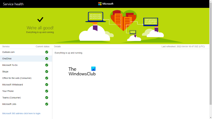

2] Check the Service Health Status of OneDrive
This solution is for users who saved their OneNote notebooks in OneDrive. If OneDrive is having issues, you will experience syncing issues with the notes you have saved in OneDrive. You can check the OneDrive status by visiting the Service Health Status page. If the page shows any outages, wait until Microsoft resolves the problem.
When Microsoft resolves the outage, your OneNote sync problems will also be resolved automatically.

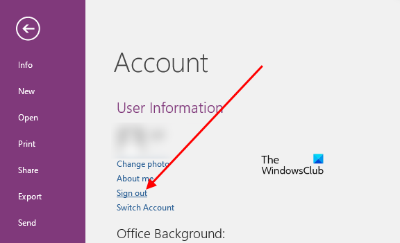

- Open OneNote or any other Microsoft Office application.
- Go to “File > Account.”
- Click Sign out.
- You will receive a prompt message “Removing this account will sign you out from this and other Office applications.” Click Yes.
The above steps will remove your Microsoft account from other Office applications.

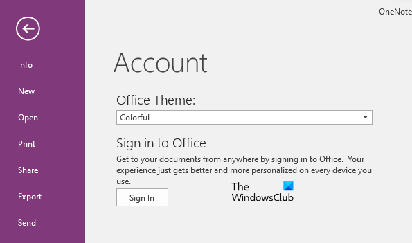

After completing the above steps, sign back in to the Office applications and link your account to OneDrive again. Simply open OneNote or any other Office application. Go to “File > Account.” Click Sign in and follow the on-screen instructions.

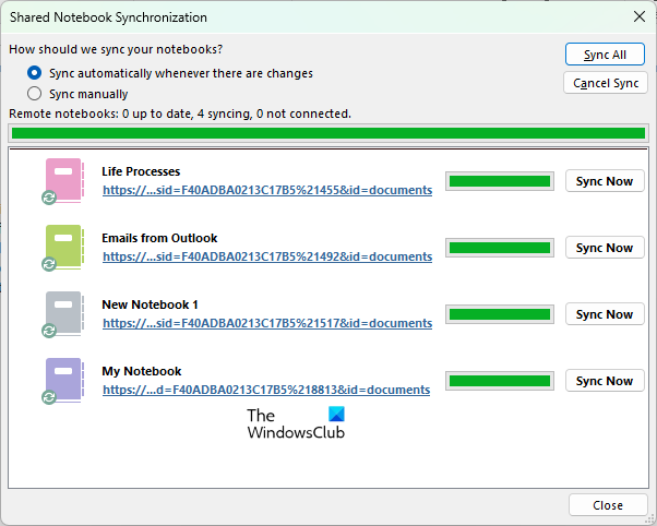

5] Force sync your OneNote notebooks
You can also force your OneNote notebooks to sync. The steps to do this are as follows:
- Open OneNote.
- Go to “File > Info.”
- Click View Sync Status.
- Select Sync automatically whenever there are changes.
- Click Sync all.

How do I force OneNote to sync?
To force OneNote to sync, open OneNote and go to “File > Info > View Sync Status.” Now, click on the Sync Now button next to the notebook that you want to sync. If you want to force sync all your OneNote notebooks, click on the Sync All button.
