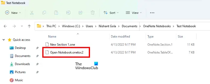

The OneNote Notebooks folder contains the folders with the names of your notebooks. Copy the folder with the name of the affected notebook.
Now, open the root folder of your main drive. The main drive in Windows 11/10 is the C drive. To open the root folder, launch the Run command box and type %SystemRoot%. Click OK. This will open the root folder. Now, paste the folder you copied in the previous step here.
Open the copied folder. It will contain a file, named Open Notebook.onetoc2. Double-click on that file. Windows will ask you to select a program to open that file. Select OneNote. This should open your netbook without displaying the error.
