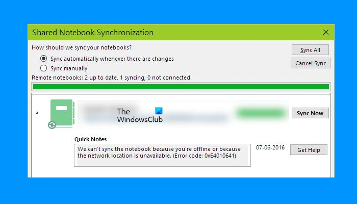

In this article, we will discuss the reasons why OneNote sync error 0xE4010641 (Network Disconnected) occurs and the ways to fix this error. When the error code 0xE4010641 occurs on OneNote, your notebooks will not sync. The error message that OneNote displays is as follows:
We can’t sync the notebook because you’re offline or because the network location is unavailable. (Error code: 0xE4010641)
It is clear from the error message that the error code 0xE4010641 in OneNote occurs due to network issues. However, there are other reasons too that trigger this error. You will see this error in OneNote if any of the following conditions are satisfied:

2] Force sync your notebooks
If OneNote is not syncing, then you can try force syncing your notebooks and see if this helps. The steps to force your notebooks to sync are explained below:
- Open OneNote.
- Go to “File > Info.”
- Now, click View Sync Status. The Shared Notebook Synchronization window will appear.
- Click on the Sync Now button next to the affected notebook.
