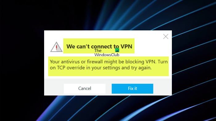

We can’t connect to VPN. Your antivirus or firewall might be blocking VPN
You’ll get the full error message below prompting you to turn on TCP override in the settings menu when you try to connect to the internet with McAfee Safe Connect.
Your antivirus or firewall might be blocking VPN. Turn on TCP override in your settings and try again.
When you receive this message, simply click the Fix it button, then do the following:
- On the Settings page, look for TCP Override in the middle of the screen.
- Now, click to toggle the button on the right side to turn on TCP Override.
TCP Override (Transmission Control Protocol Override) advanced setting (turned off by default) in Safe Connect forces the desktop app to use a slightly slower, but more reliable method (or ‘tunneling protocol’) to transmit data over the internet which results in a more stable connection on an unreliable network connection which you’ll find useful when you perform activities such as payment transactions, or while you use your banking websites.
