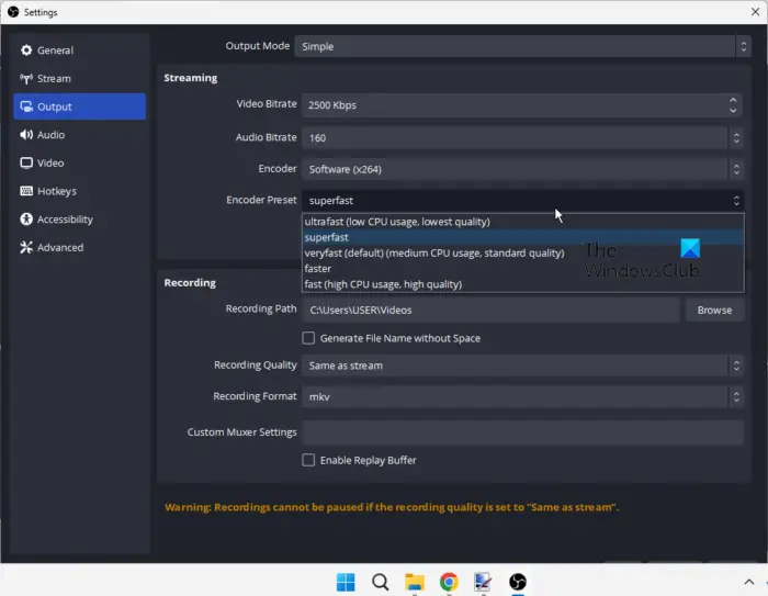

3] Change the encoder preset
OBS uses the x264 video encoder by default. Now, it has multiple presets that you can use for encoding a video. These presets are different in terms of video quality and CPU usage. The “fast” encoder preset has a high CPU consumption and produces high-quality video, while the “ultrafast” preset consumes low CPU usage but gives a lower video quality. If you have chosen a slower preset than the rest like fast, it will have higher CPU usage that might result in the “Encoding overloaded” warning. Hence, choose a faster encoder preset to fix the issue. You can select the “veryfast” encoder preset that has medium CPU usage and give standard video quality.
Here are the steps to change the encoder preset in OBS:
- First, launch OBS and open its File > Settings.
- Now, move to the Output tab from ht left-side panel and click on the Encoder preset drop-down button.
- Next, select a faster preset like veryfast, faster, or superfast encoder preset.
- After that, press Apply > OK to save changes and then relaunch OBS to check if the problem is resolved.
If you still get the same error message, move on to the next solution.

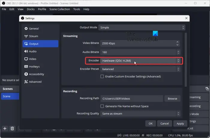

4] Use hardware encoding
To lower CPU usage, you can use a hardware encoder like Quicksync (Intel Integrated GPUs), AMF (newer AMD GPUs), or NVENC (latest Nvidia GPUs). However, these hardware encoders give lower video quality but also put less stress on your CPU. Hence, it is recommended to use a suitable hardware encoder from these. Here are the steps to change the hardware encoder in OBS:
- First, start OBS and go to Files > Settings.
- Now, go to the Output tab and set Encoder to Hardware. For example, as mine is an Intel GPU, I could select Quicksync hardware encoder.
- Lastly, tap on Apply > OK and then restart OBS to check whether the “Encoding overloaded” warning has stopped or not.
