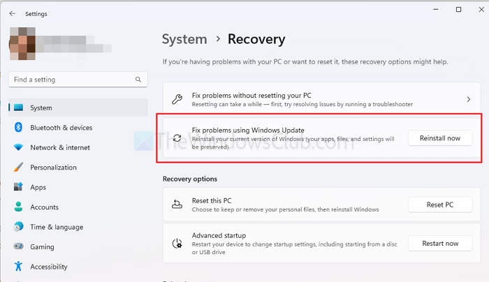

3] Reinstall Windows using Windows Update
If the above methods don’t work for you, you can still update your Windows using the Media creation tool. Here’s how:
- Press Windows Key + I to open Settings.
- Go to System > Recovery.
- Click on the Reinstall Now button next to Fix problems using Windows update and follow the onscreen steps.
This will reinstall your current Windows version without deleting any of your apps, files or settings.
So those were a few quick ways to get rid of the 0x8024800A, WU_E_DS_UNKNOWNHANDLER, The update wasn’t processed because its update handler couldn’t be recognized error. In case, none of the above methods work for you, you might want to consider reinstalling Windows using the Windows media creation tool.
