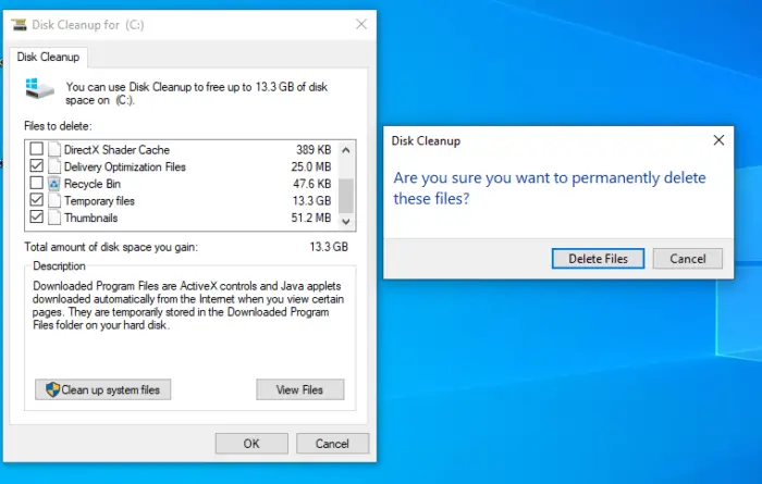

4] Clean up Windows Registry files
Microsoft does not support any registry cleaners, but we can use its Disk Cleanup utility. The tool can be used to clean up apps and drivers’ leftovers that may trigger the 0x8004100e error. Some registry files might be corrupted or cluttered, and the best way to fix this is by running the inbuilt Disk Cleanup tool. To run the Disk Cleanup utility, follow the steps below:
- Type Disk Cleanup in the Windows search box and click Open. Wait as the tool tries to calculate the size of files that can be deleted permanently.
- A new small window will pop up. You may select the files to delete by ticking the box next to them.
- Click OK and wait for the tool to clean up your disk.
- Once it’s done, reopen the Disk Cleanup tool and select Clean up system files
- Again, wait for the tool to calculate the amount of space that can be cleaned up.
- Another small window will pop up. Navigate through the Disk Cleanup and More options to locate extra files to clean up including leftovers by nonexisting programs.
- Once you are done with file selection, click OK and let the tool delete them automatically.
