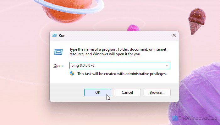

2] Check your internet connection
It is the second most important thing when adding a new account. If your internet connection is down and you try to add a School account, you cannot go through the process. You can validate it by running the ping command.
- Type ping 8.8.8.8 -t and hit the Enter button.
If it displays continuous results, your internet connection is fine. Otherwise, you need to look for solutions to make it up again.

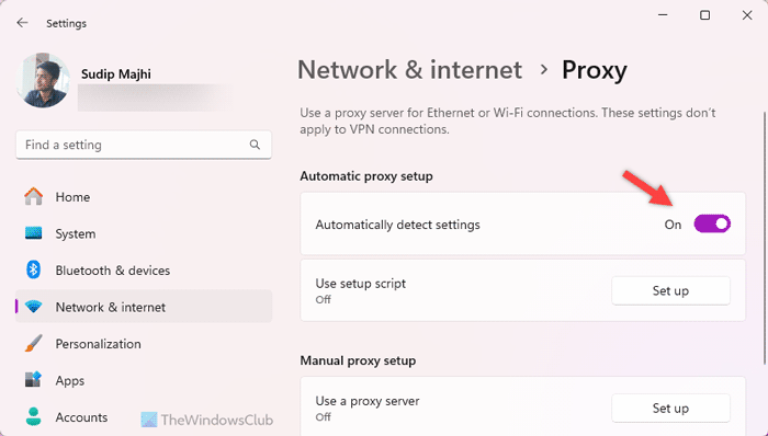

3] Disable VPN and proxy temporarily
At times, your internet connection could be interrupted due to having problems with the VPN or proxy server. That is why we suggest you temporarily disable VPN and proxy and check whether it fixes the problem.
I hope it fixed your problem.
