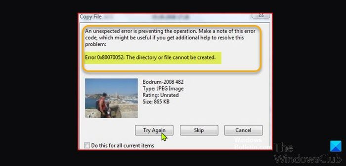

If when attempting to copy files to a removable media like a flash drive or external HDD, and you encounter the copy operation error message The directory or file cannot be created with accompanying error code 0x80070052, then this post is intended to help you with the most suitable solutions to resolve the issue.
When you encounter this issue, you’ll receive the following full error message;
An unexpected error is preventing the operation. Make a note of this error code, which might be useful if you get additional help to resolve this problem:
Error 0x80070052: The directory or file cannot be created.
In most cases, the issue is reported to occur with photos and videos (especially files with names exceeding 20 characters). The following are the most likely culprit to this error;
- The directory or file name already exists on your USB.
- The directory path could not be found on the drive.
- There is no enough disk space on the USB.
- The file or the directory name is invalid because it contains unacceptable characters.
- The USB drive may not be formatted properly.
- Windows system files are damaged.
