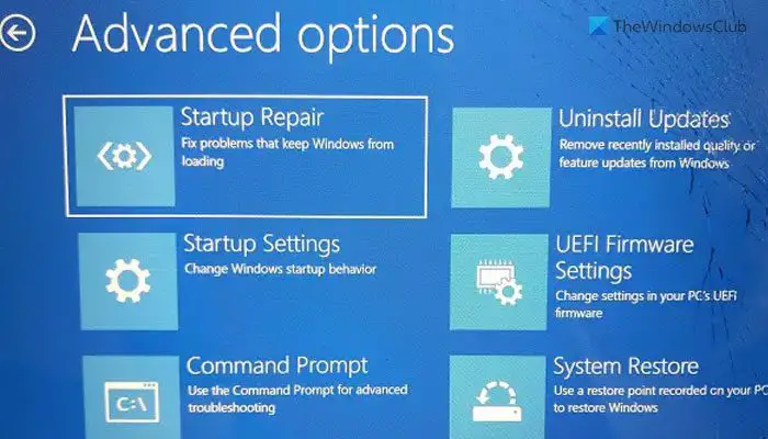

1] Use Automatic Startup Repair
It is the very first thing you need to check when you are getting the aforementioned error. In case you don’t know about this functionality, this utility helps you resolve various startup failures within moments. That is why it is suggested to use this option first.
As you cannot boot your computer, you need to use an installation media to opt for Automatic Startup Repair. However, it might open automatically if you restart your computer multiple times in a small span of time. Nonetheless, if that is not the case, you can follow this guide to repair Windows computers using installation media and Automatic Startup Repair.
There could be times when Automatic Startup Repair might fail to repair your computer. In such situations, you need to follow other solutions.
Read: Fix Automatic Startup Repair not working

4] Use System Restore
If you have done all the things but the problem still appears at times, it is recommended to use the System Restore point. There could be malware, adware, or corrupt system file. If so, System Restore could help to troubleshoot the issue. You can use an installation media to opt for the Advanced Options wizard. Following that, you need to choose the Troubleshoot option when you can find the System Restore menu.
Read: How to boot to Windows Recovery Environment
