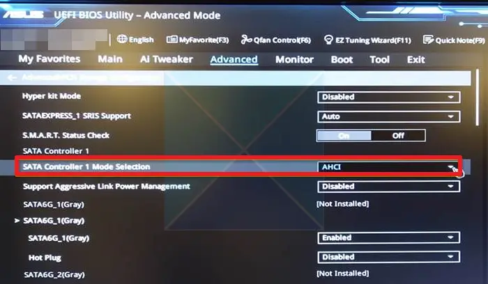

2] Check the Hard Drive in BIOS
You should also ensure that your Hard Drive is being shown up in the BIOS and it has the correct settings.
- To get into the BIOS menu, restart your PC and constantly press the Delete key. The Delete key should work for most desktops/laptops. But you can always search for the correct key combinations to enter the BIOS for your desktop or laptop model.
- From the BIOS, go to the Advanced menu.
- Then make sure that your SATA configuration is set at Enhanced.
- And your Sata Controller Mode setting is set at AHCI.
- If these settings are correct, save the changes, reboot your PC, and boot up again to see if it works for you.
Also, if you don’t see the HDD in your BIOS – there is a high chance that your HDD is faulty.
Note: The BIOS menu differs from one PC to another, so the steps may vary a bit for you.
