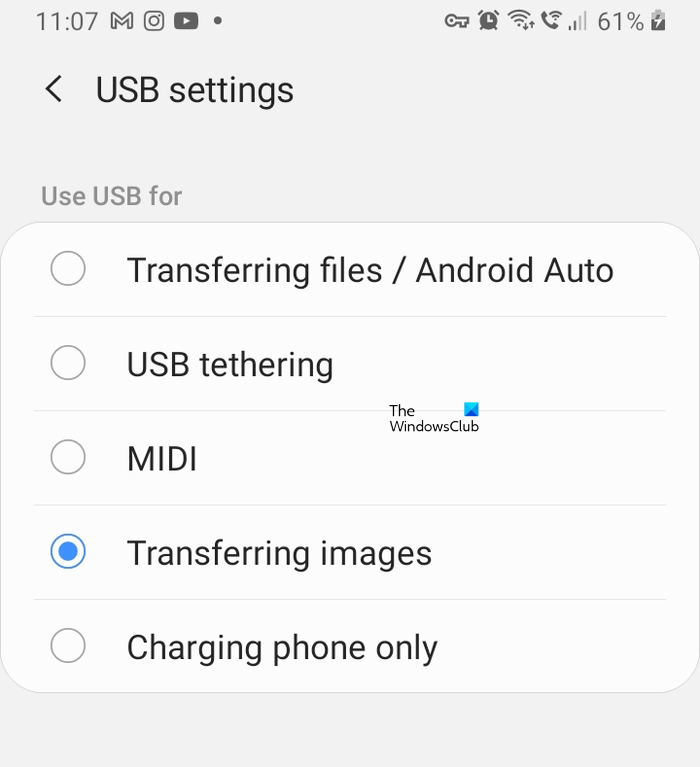

3] Change the USB file transfer settings
If you want to transfer only images, you can change the USB file transfer settings. By default, the Transferring file option is enabled. Change it to Transferring images and see if it works. The following instructions will help you:
- Pull down notifications on your smartphone.
- Tap the “Charging this device via USB” or “USB for file transfer” notification.
- The USB settings page will open. Select the Transferring images option.

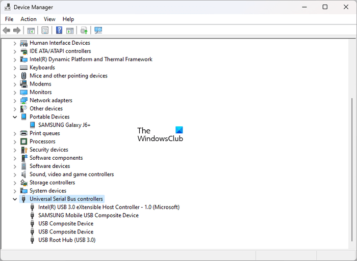

5] Check your drivers in the Device Manager
If the issue still persists, the problem might be associated with your device drivers. Open the Device Manager and see if your device driver is showing you a warning sign. Go through the following instructions:
- Open the Device Manager.
- Expand the Portable Devices and Universal Serial Bus controllers branches and see if your smartphone driver is showing a warning sign or not.
- If you see a warning sign, uninstall your smartphone driver and restart your computer.
In addition to this, we also suggest you uninstall the USB Root Hub driver and then restart your computer.
